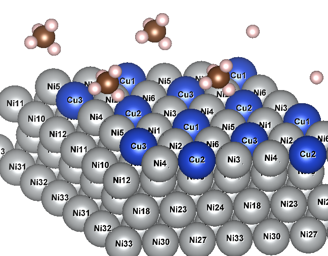

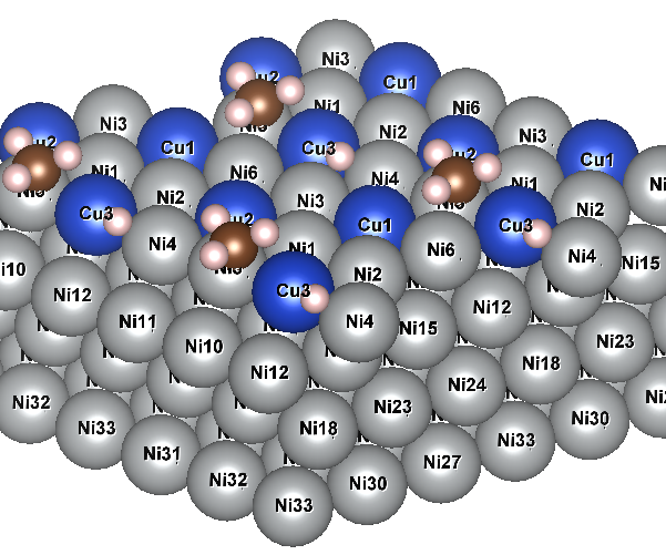

The "negative" barrier is likely because what you have shown is not an elementary step. As Prof. Henkelman pointed out, your initial and final states do not involve H-abstraction at the same proposed active site. What I imagine happened is that the transition state you found is best represented as a diffusive barrier, which is why it appears "negative" -- the highly exothermic C-H activation has already taken place prior to the transition state you observed. Refer to Fig. 5 in Ref. [1] below.
To clarify this, look at the snapshots below. It looks like you were anticipating the H atom to get adsorbed between Ni3, Ni6, and Cu3. However, in the final state, it is adsorbed between Ni3, Ni4, and Cu3 instead. You can see from this set of images that the process involves both H-abstraction and subsequent diffusion of the H* species. I would get a more appropriate final state and then rerun your set of calculations, unfortunately starting from the coarse CI-NEB calculation again. If you use dimmins.pl on your dimer calculated TS, I am fairly confident you would not get back your initial and final states that you propose, indicating that the TS does not directly connect your proposed local minima. Also, on a potentially related note -- is there a more stable initial state with CH4 adsorbed closer to the surface near the proposed active site? It seems a bit far away from the surface, but perhaps it's just very weakly physisorbed to the metal surface.
[attachment=0]1.png[/attachment]
[attachment=1]2.png[/attachment]

Thank you very much for your insights and detail.I have already tried dimmin.pl with the 0.1 displacement and with now change in the result still same with "negative" barrier .I will give another chance with 0.2/0.3 displacements to see if any difference.
Meanwhile,I will try a new starting point and look for more appropriate final state , repeat cNEB again.In fact,I believe that the problem is more related to initial state rather than final state.Unfortunately,this is almost closer initial state to surface as it is very weakly physical adsorption (-.024) as you anticipated.
