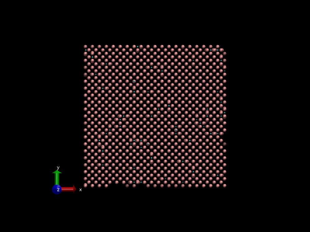

I am running Eon-akmc simulations on a metallic system. We are trying to simulate interstitial diffusion in a perfect lattice (bcc). I am using the dynamics method for saddle searches and performing dynamics at an elevated temperature of around 1200 K. The Config file is attached here.
During AKMC moves the barrier between the states (for interstitial jumps between two minima) should have a value comparable to 0.8 eV (based on known activation energy barriers in this system). However, we are finding several lower barrier values of around 0.3 - 0.45 eV. Apparently, EON uses these lower barrier values to move the interstitial atoms, rather than the known diffusion barrier values of 0.8 eV. In the visualisation of different states, I found some distortions in the lattice at the boundaries and the interstitial atoms which moved were generally found at the surface (most likely, corresponding to the lower barriers of 0.3 – 0.45 eV).
To me, surface distortions seem to suggest a finite-sized system. Is this true? Does EON assume periodic boundary conditions by default? If not, how can we implement/change boundary conditions for the dynamics run? The snapshot for different states are also attached here.
Would someone be able to help me resolve these issues? Is there a possibility to restrict the surface distortions in the metal matrix during dynamics? Or preventing or discarding the lower barrier value while making akmc moves?
I am attaching the snapshots of different states where you may be able to see the distortions at the surface also.

As you mentioned, I have constrained only the interstitial atoms to move during AKMC bydisplace_type_list command. I suspect that the distortion in the lattice is due to the dynamics run only. However, the interstitial atoms which were moved during generally found at the lattice boundaries only. I am attaching a part of the eon-dynamics during the AKMC run to better visualise the problem.
With reference to a previous thread - http://theory.cm.utexas.edu/henkelman/f ... hp?t=11664 I have also tried to implement the max_rate command to my system in order to restrict any other faster events. I have uncommented the max_rate implementation in akmcstates.py and akmcstatelist.py in the source code as shown below.
Although the log does state that the event has exceeded the max_rate limit for low barrier values, but it still chooses it for making an akmc move. I think the code does not omit the higher rates, it just assigns the maximum allowed rate as the process rate to such events.
I am also attaching the screenshots of the config file and dynamics.txt generated during the EON-AKMC run.

- ezgif.com-gif-maker.gif (636.95 KiB) Viewed 111905 times

It's hard for me to tell what is going on from the movie. The movement that you indicate could (in my eye) just be atoms moving across the periodic boundary conditions. Well, maybe there is a small diffusion event for the interstitial at the top-left of the simulation. I would like to see (i) what is the potential and (ii) what are the low barrier processes. It think this is a better place to start than jumping to the max_rate tricks, which will give you only approximate dynamics.
