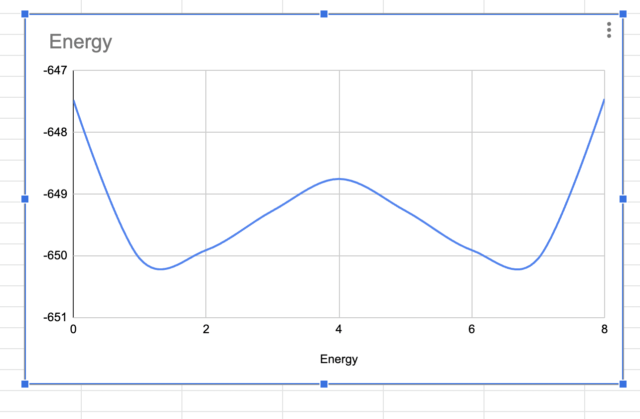

Dear Prof. Henkelman,
I did try running the neb with the above settings and was surprised to see that it converged within an hour itself! However i get an energy barrier like this - please see thr attached figure. Is it ever possible that the initial and final states have higher energy than the transition state itself?

Check that the settings on the endpoints are the same as the band. You will (almost certainly) find that they are different. Note: I put OUTCAR files in 00 and 08, which need to be consistent with the settings of your NEB calculation.
