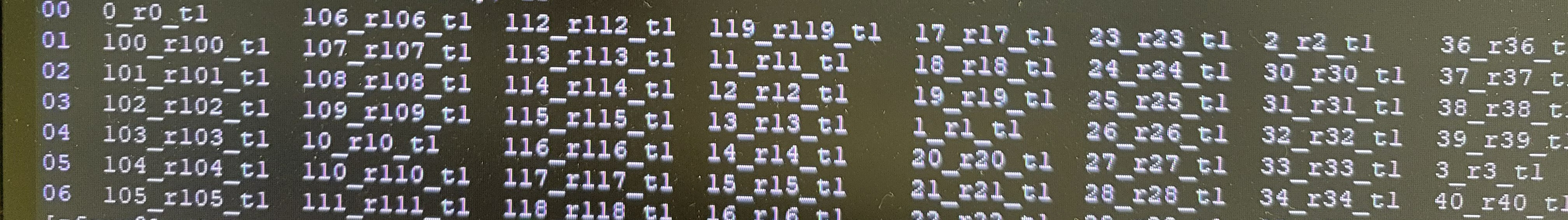

(2) Another issue was the calculation generated lots of *.t1 files with one file for one core. please check out the attached.
Not sure if it is from VTST itself or compile. There was no this issue for the version without VTST.
