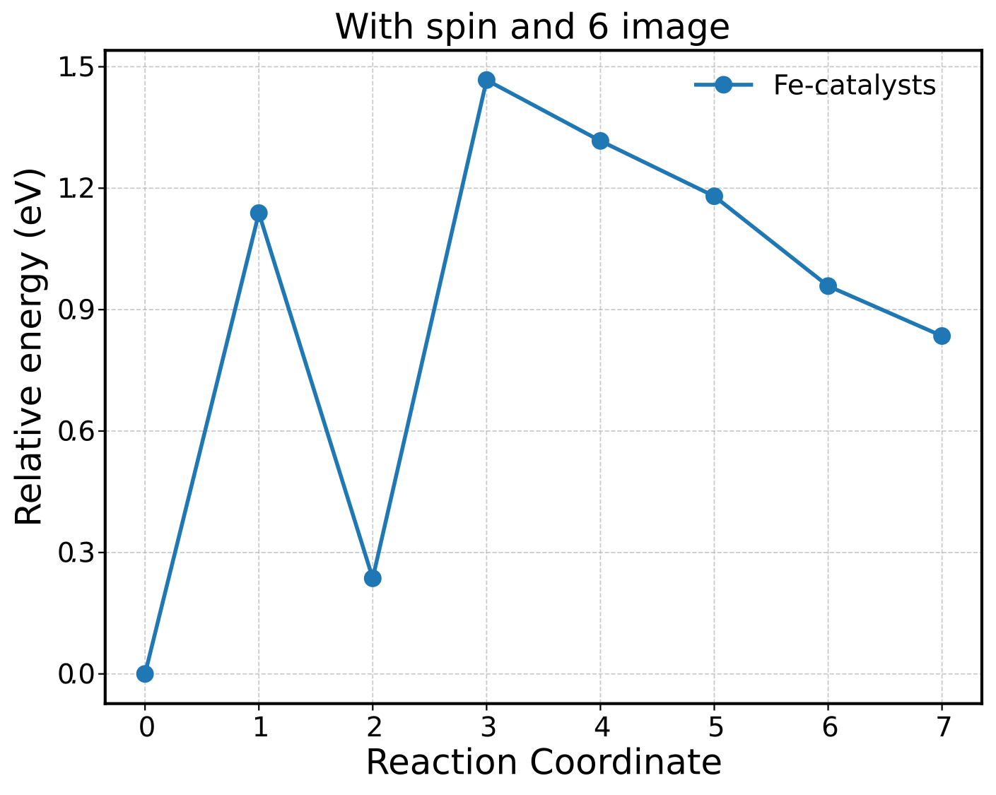

But I am getting some weird energy barrier (attached image with_spin_and_six_images.png)

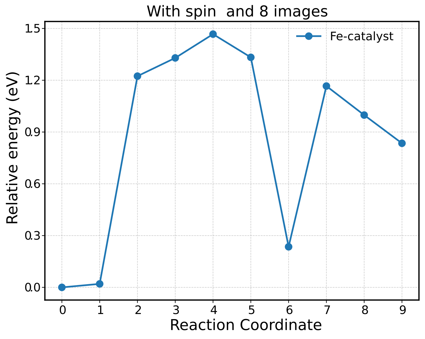

Also, I repeated the same calculation with eight images (attached image with_spin_and_eight_images.png)

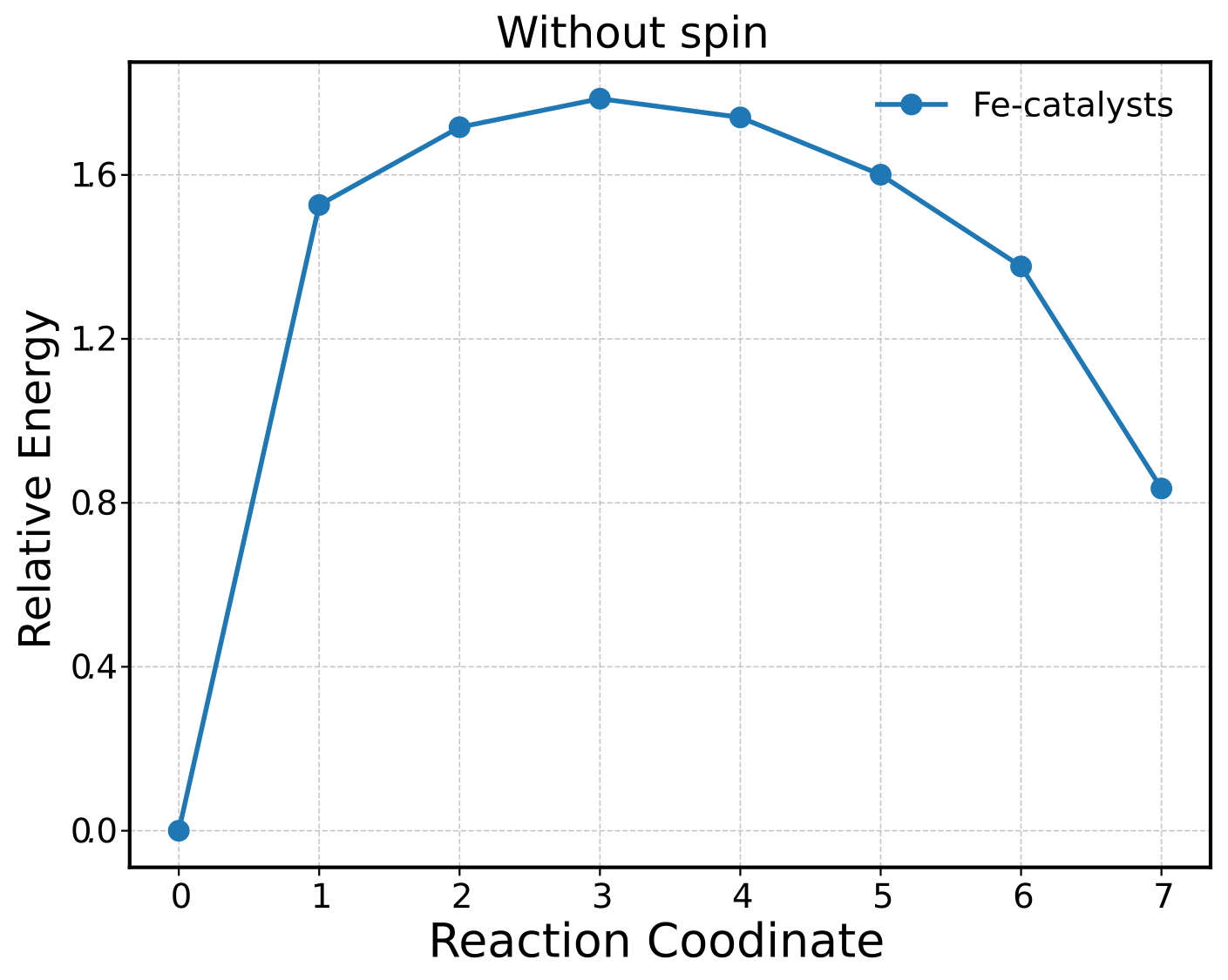

Finally, I have did the energy barrier calculation without spin (attached without spin.png)
Note: all the calculation are conveged with EDIFFG = -0.05

Dealing with spin can be challenging, especially if you use DFT+U. You just can not expect that vasp with automatically reach a low-spin state, especially when it starts with a very high spin state by default. Instead, you need to help the calculations as much as possible using parameters such as MAGMOM.
In terms of your specific question, I can look at the electronic structure, but I'm pretty sure that images 1, 3-6 will have different spin states than 0 and 2. There is a similar issue for band 2, and likely for 3.
So then you have to decide if you take a consistent spin state across your band, or more typically assume that you want the lowest energy spin state. We have a few tricks for finding the lowest energy spin state, but I would start with looking at each image individually, using magmom to help get the spin state that you want, and then if you still have problems, doing single-point calculations on any problematic image and restarting the NEB using that charge state.
