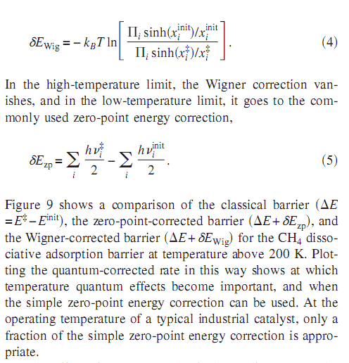

Re: How to make a ZPE correction for saddle point?
The simplest ZPE correction is to add 1/2 hbar * omega for each positive mode at any geometry.
This is a good approximation at low temperature, but at temperatures closer to the Debye temperature, equation (4) with the sinh functions provides a better approximation. Our script called dymeffbar.pl can do these calculations.
