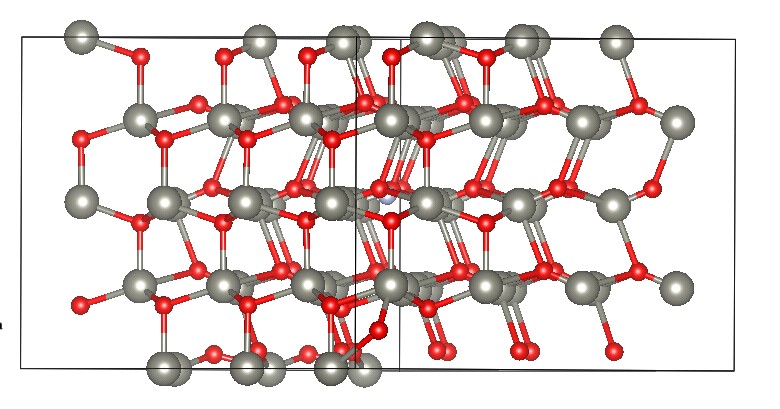

as one N atom from the interstitial site to the another
dear professor, when i perform the NEB calculation, there is a problem i have met. the structrue is damaged. I use the IBRION=3 ,EDIFFG = -1, POTIM = 0, IOPT = 3.

this is one of the transition states of system
[attachment=1]NEB-Ninter--No-Osub--Ointer-442-6images-6-29-node4.zip[/attachment]

Hi,
I was wondering that what you mean by "damage". Besides, why is your force convergence so high?
