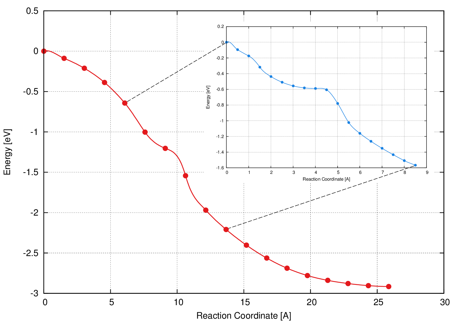

I'm investigating surface adsorption of molecules with NEB, so one end of the system is normally the molecule far away from the surface which is not a minimum. When using the nebresults.pl scripts from your (by the way, excellent) vtstscripts, I noticed that between image 0 and 1 there was a bump appearing every time, so the spline first went up in energy and then down.
In that case it isn't really a big issue, but I also use intermediate images from a converged NEB to run a more detailed calculation with more images inbetween. Here, the bump also appeared at image 0 and the gradient pointed upwards when in the previous coarse calculation it definitely pointed downwards. I think the script changes the sign of image 0 and I will explain to you why in a minute.

The gradients from Calc 1, Image 9 and Calc 2, Image 17 (same structure) don't perfectly align, but they fit rather well, while those from Calc 1, Image 4 and Calc 2, Image 0 seem to be almost exactly the same except for the sign!

(By the way, I also added an image with the plots from the original neb.dat outputs)
