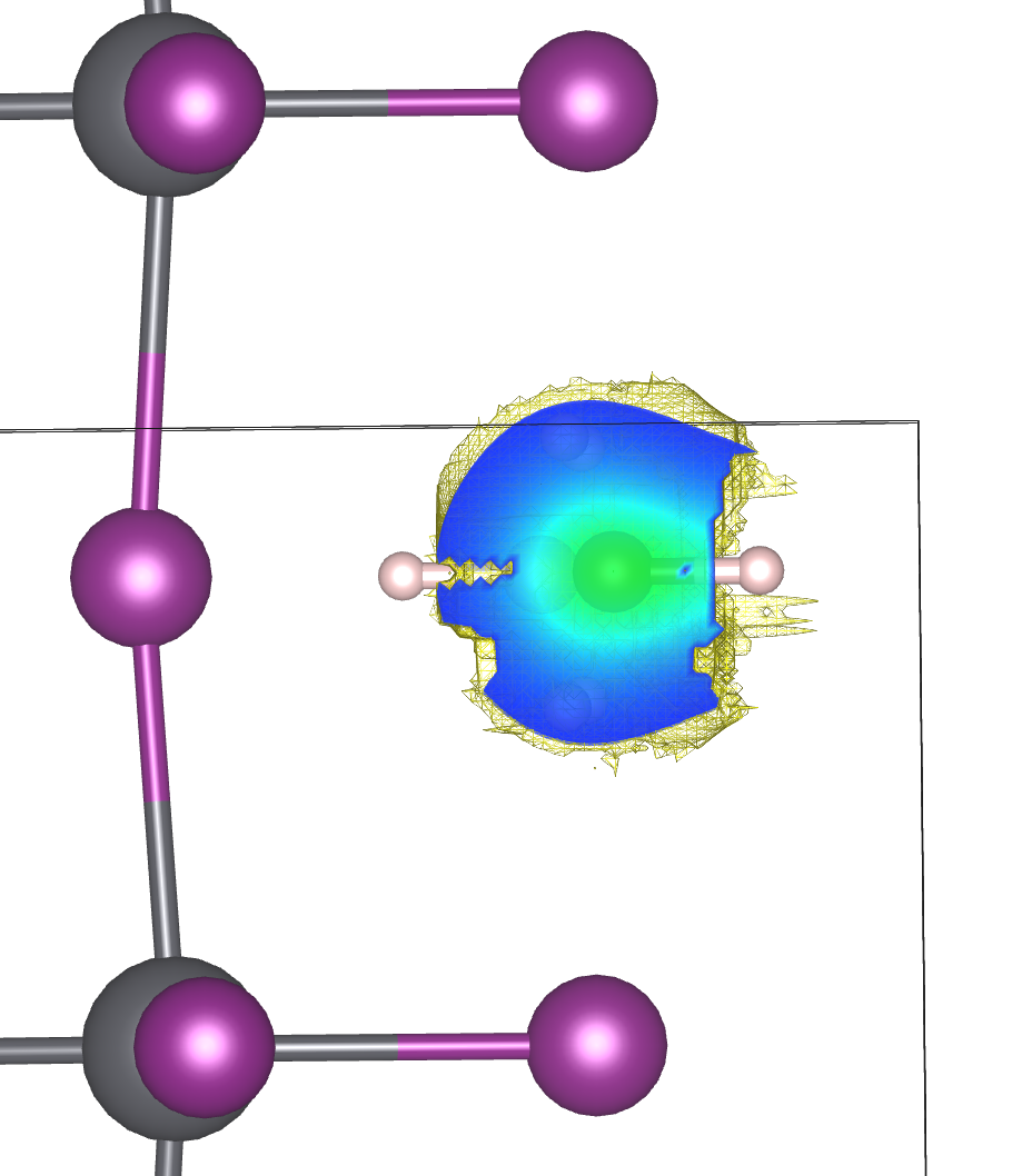

I'm just not sure what you are asking for. I explained how to write the charge density in a Bader volume around a single atom. If you want to see a contour plot of the charge density inside that sphere, you can do that with a visualizer (see attached). But I don't really understand the words "draw contours for Zero flux region".
Screen Shot 2020-02-06 at 3.13.50 PM.png (414.91 KiB) Viewed 324550 times
