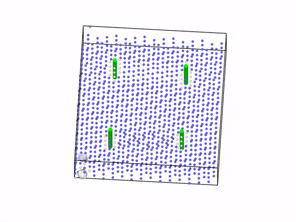

In a related topic, I am trying to simulate the diffusion of C in Fe. The system contains a single C atom and a dislocation quadrupole.
Initially, I let EON select randomly the epicenter of each transition to a new state. Since the energy barriers for the movement of the dislocations were much smaller than those required for C diffusion, the result was that the dislocations started to move while the carbon remained at the same position. See attached video/gif.
Since I am interested in the diffusion of C, I ran a second try which consisted in including the following 2 commands in the config.ini file :
Code: Select all
displace_type_list = C
displace_listed_type_weight = 1
I was expecting that this would force the transition to occur centred around the C atom. Unfortunately that was not the case. The transitions that EON find still correspond to the motion of dislocations.

Re: displace_listed_type_weight
Sebastián,
You have identified the Achilles heal of this simulation methodology. In many cases, when you follow the state-to-state dynamics, you find that there are low-barrier processes that occur (and should occur) even when you don't care about them. We have just a few ways to deal with this problem. One is coarse-graining, where if you revisit states connected by low barriers, they will be lumped into superbasins and the dynamics will proceed outside of those superbasins, where the internal (fast) dynamics in the superbasins are treated analytically. A second strategy is to specify a maximum rate, so that any faster event is set (artificially) to the specified max_rate. This is approximate, and should be used with caution, but it will allow for fast processes that are known to be in quasi-equilibrium to occur at a slower rate than they should. Basically you can say that any event occurring on a time scale faster than say 100 ps is equilibrated, then you can set the rate of that event to the max_rate = 1/100ps, so that you are able to see the slower dynamics of interest.
If you ever want to have someone in the group look into this, we are always happy to help with such projects, especially when they involve method development.
Graeme
