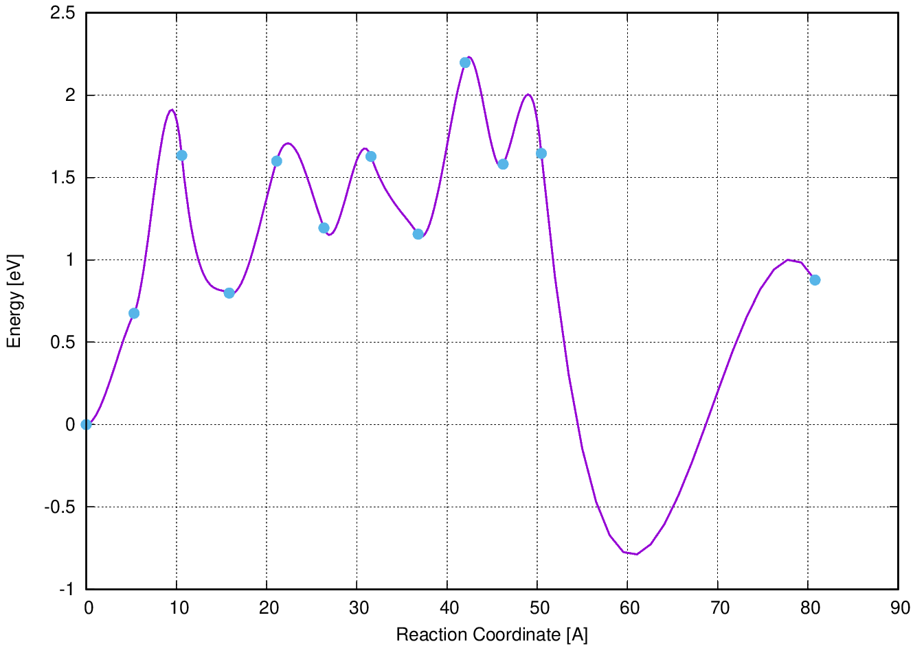

Re: NEB converge problem with different number of images
Dear Professor Graeme Henkelman,
I completed another set of simulations but couldn't interpret the migration barrier plot and why there are multiple saddle points along the path. Can you kindly take a look? I am adding the simulation files and the plot here.
Also using nebefs.pl, the images (1,5,8,9,10) do not converge even after 2000 ionic steps! Can you please suggest how to improve this?
Again, there is a problem with your initial band. If you look at the initial movie (attached) you can see that atom 22 moves vertically as it should from images 0 to 10, but then in image 11, it jumps back down to the 11.7 Ang plane in place of where atom 23 was in image 10. Then the ordering of the atoms in that plane are scrambled between image 10 and 11. Given that crazy initial path, the NEB path is over 80 Ang trying to move atoms around between their positions in image 10 and 11.
Again, minimize your initial and final states, which are images 0 and 11, and then make sure that you have a sensible initial path between them before starting the NEB calculation.

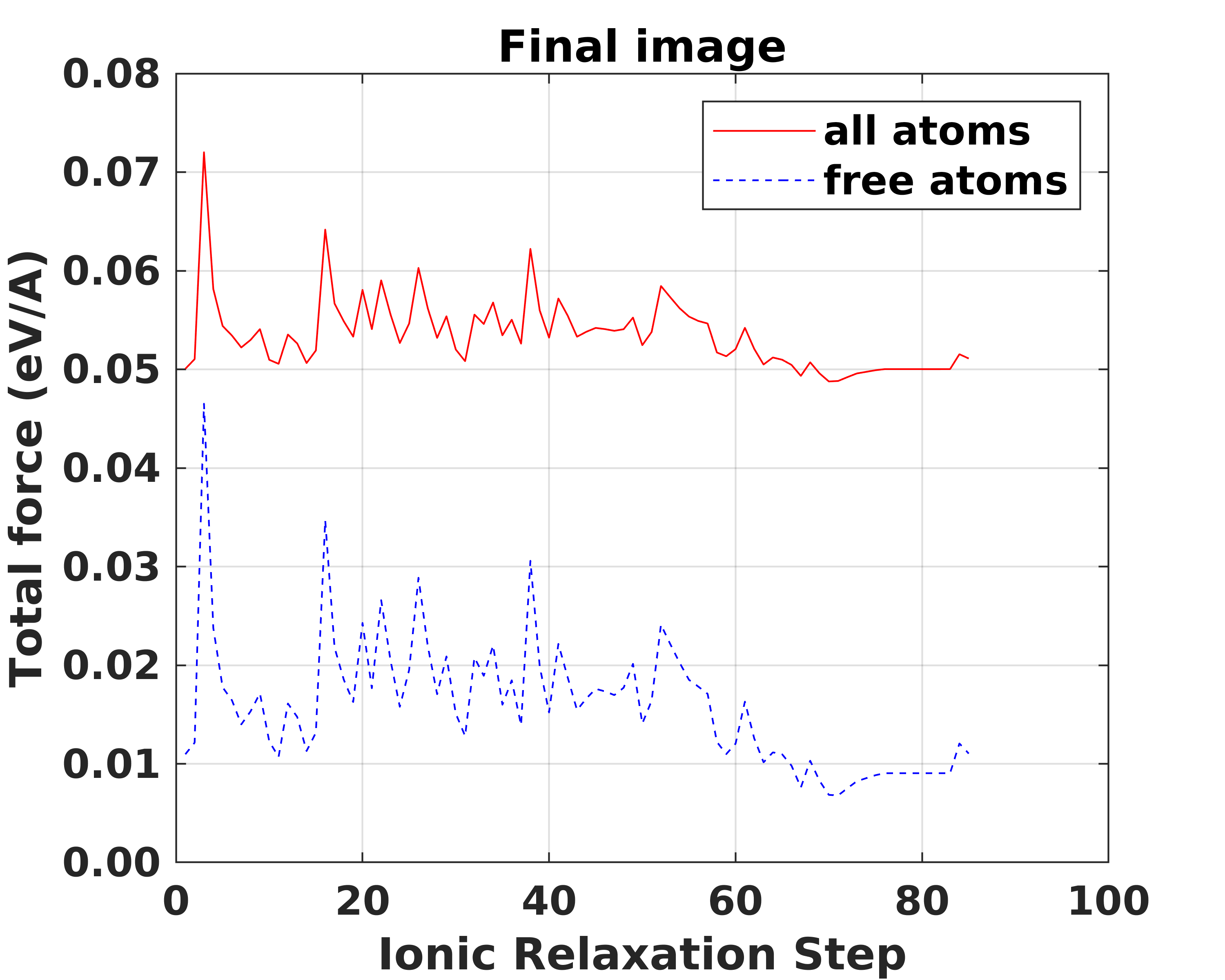

Hello Professor,
Thanks for the reply. I checked the movie and the cell was shrinking. I optimized the structure again and added the initial structure here. Though all atoms are not converging below 0.01 ev/A, the free atoms are converging below 0.01ev/A. Should I consider the attached path reasonable to start neb simulation?
Sincerely,
Musanna
Sincerely,
Musanna
