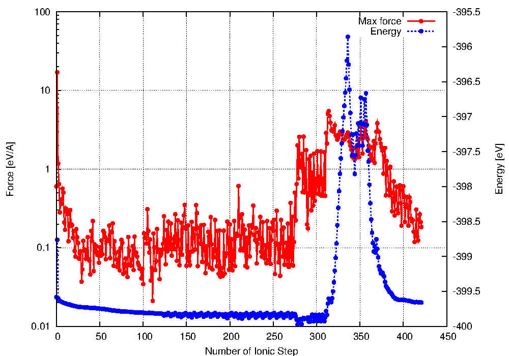

I am trying to use cNEB to find the MEP for a molecule bridging two adatoms to go from the flat, bridging geometry to an upright geometry. I have converged both the initial and final state geometries to the convergence level that I am using for the cNEB. The difference in energy between the two states is ~0.75 eV. It appears that the saddle point is very close to the initial state. This makes sense because a bond would have to be broken before the molecule can rotate to the upright geometry. I am not familiar enough with NEB calculations to know if this could be the cause of my issues (seems like this could be a common phenomenon when searching for a MEP). The calculation seems to have been going ok at first and then seems to become "unstable" after ~250 steps (see attached images). The INCAR is given below:

We would have to see the output to debug this further. For a start, however, try running with a conservative optimizer, such as IOPT=3. If this has the same problem, it would be good to look into this further.
But also, check the geometry when you see the forces start to rise. You may find that the band has found a lower energy pathway, and is falling off a shoulder towards it.

Thanks for your advice. I was going to let it keep running with the LBFGS optimizer since the forces and energies had started coming back down. However, I accidentally ran the nebresults.pl script in the directory where the job was running and crashed it (rookie mistake!). I have attached the MEP plot from the unconverged calculation for reference. As I said previously, it appears that the saddle point is very close to the initial state. I have also included the vaspout plot for image 1. If you have a chance, could you take a quick look at the plots and see if anything looks wrong?
I have decided to start the job over with the Quick-Min optimizer as you suggested. I have also changed EDIFF from 1E-5 to 1E-6 to make sure the forces are accurate enough. If that also has problems, I will definitely contact you with the output for help in determining the cause.
