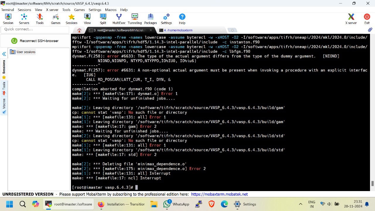

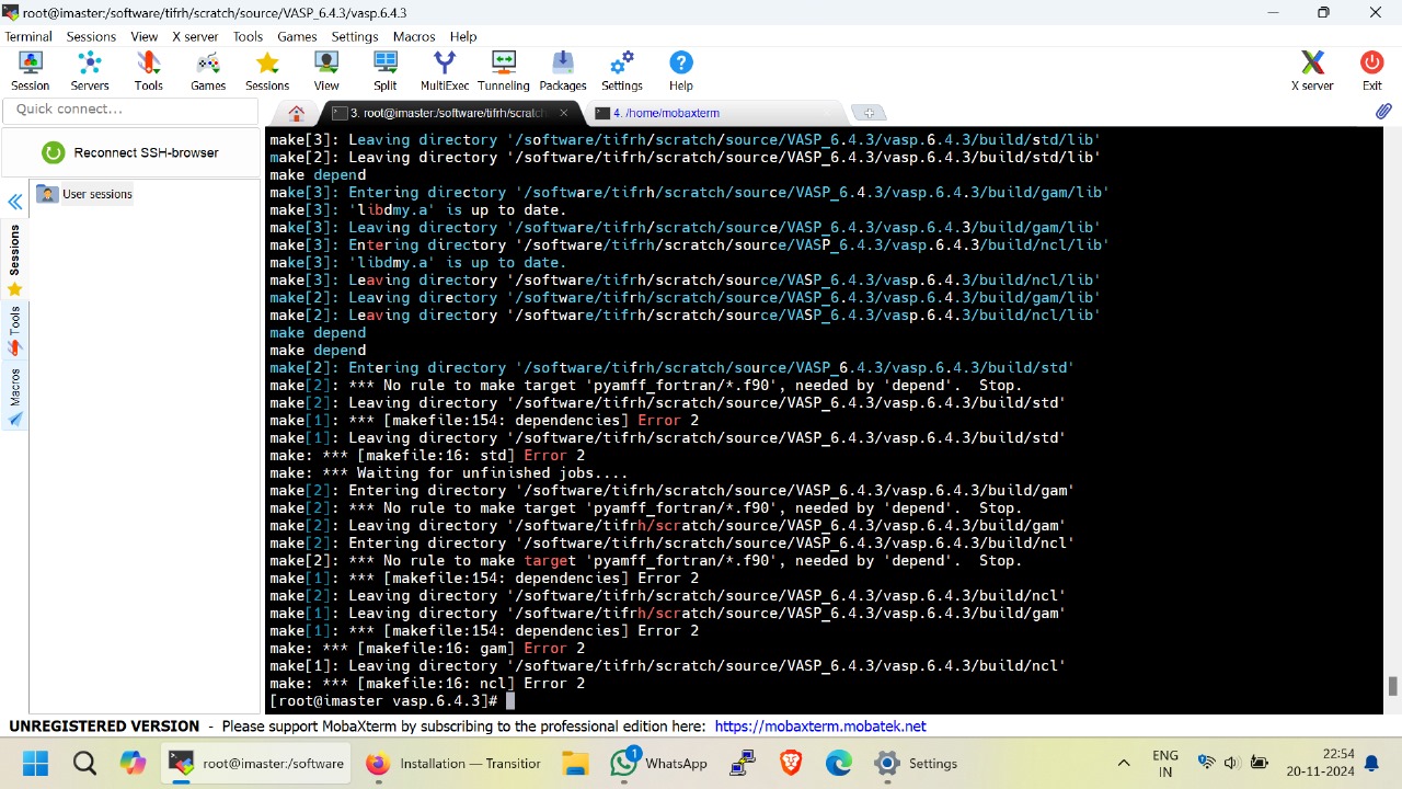

Hi,
We have been trying to install VTST tools (all 6. x versions were tried) with VASP 6.4.3 in our HPC clusters, but all the versions gave out the error and we were unable to complete the compilation. I have already seen one discussion thread addressing this issue but couldn't figure anything out of it. Could you please help us with the installation (All the steps mentioned on the installation page were performed, but still encountered these errors?).
Waiting for your reply,
- WhatsApp Image 2024-11-20 at 22.54.56.jpeg (336.45 KiB) Viewed 344818 times
- WhatsApp Image 2024-11-20 at 23.17.22.jpeg (393.33 KiB) Viewed 344818 times
- WhatsApp Image 2024-11-20 at 23.31.29.jpeg (281.48 KiB) Viewed 344818 times
Re: Regarding installation of VTST tools (6.x) version with VASP 6.4.3
Ok, let's start with the first issue.
(1) download a clean version of the vtstcode and copy it from the vtstcode6.4.3 directory to your src directory. Check that it has version 4.2 listed in chain.F: VTST: version 4.2, (11/09/24)
(2) edit your src/.objects file to include the new objects, for example:
VTST_OBJS = bfgs.o dynmat.o instanton.o lbfgs.o sd.o cg.o dimer.o bbm.o \
fire.o lanczos.o neb.o qm.o \
pyamff_fortran/*.o ml_pyamff.o \
opt.o
hamil.o \
$(6VTST_OBJS) \
constrmag.o \
Let's do that first and then deal with the subsequent issues.
opt.o
hamil.o \
$(6VTST_OBJS) \
constrmag.o \

Hi,
As informed we have tried to build VTST accordingly as instructed by you in VASP in HPC, but we are still encountering some errors. Could you please let us know about it as we need these tools as early as possible?
Snehith.
Snehith.
- IMG_0136.jpeg (309.81 KiB) Viewed 325032 times
