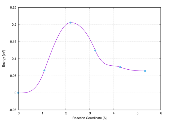

Dear Dr. Graeme,
I hope you are doing well. I wanted to share the results of my CI-NEB calculation and sincerely appreciate your insights on my approach.
For my study, I inserted a single lithium atom into my AIMD-quenched (300K) amorphous Mo₃S₁₃ structure, selecting both the initial Li placement and final positions based on an educated guess. Given the amorphous nature of my system, which contains several voids, I am wondering if this is the best approach for studying Li-ion diffusion.
Would you recommend a more systematic way to determine the initial lithium placement and final positions, considering the lack of experimental data to guide my choices? Your expertise would be invaluable in refining my methodology.
I look forward to your feedback. Thank you for your time and guidance.
Best regards,
Emmanuel

Re: Inquiry Regarding High Energy Barrier in CI-NEB Calculation
These looks much better and physically reasonable.
You have, however, identified an important challenge. This is a disordered material and so it will take more than a single barrier to quantify diffusion in the material.
