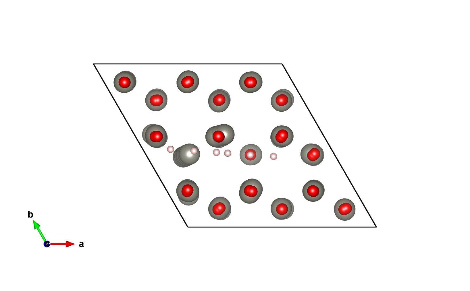

In my tests I got convergence using VASP's ibrion=1 without the VTS patch. However using a VTS patched version results in a 'outwards' movement of the hydrogen in image 01 and 04 (IMAGES = 4) of the neb chain as can be seen at the attached images. Please find the details of the calculation in the dropbox link below.
http://bit.ly/vts_neb_zno
[attachment=0]contcar.jpg[/attachment]
[attachment=1]poscar.jpg[/attachment]

Re: Divergence using VTS
The problem is that your atoms are listed in a different order in the endpoints as compared to the moving images.
Thank you very much for your quick reply, this was indeed the problem.
