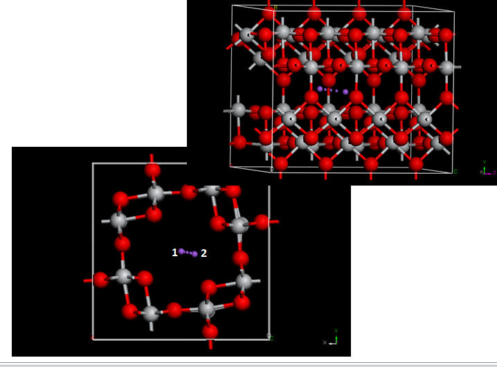

I would like to ask you a question regarding the importance of drift in NEB results. I am considering a hop from the minimum configuration of my system to a local minimum nearby 88meV higher in energy (indicated in the attached figure) (system TiO2, hopping ion Na)

NEB calculation, Drift importance

- forum.PNG (166.91 KiB) Viewed 21017 times
