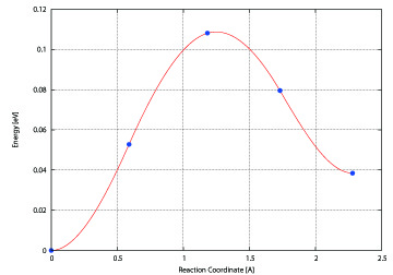

I have also attached the MEP profile created by nebspline.pl, for a CI-NEB calculation that shows the Image 2 is not located at the expected position.

The energy path looks reasonable.
One comment: you can run the climbing image right from the start. This will be more efficient than converging a regular NEB and then turning on the climbing image.
One thing that I can not tell from what you have posted is how well converged the band is and what your convergence criterion is. If you use EDIFFG=-0.002, the highest energy image should converge very close to the saddle (top of the MEP). Check the residual force, to see if the climbing image is still converging or if you need to tighten your convergence criterion.

So many thanks for your prompt answer. I used EDIFFG=-0.02 in my calculations. Just one more question: Does CI-NEB work well with PBE-D2 or PBE-D3?
Re: CI-NEB problem
it should be fine.
