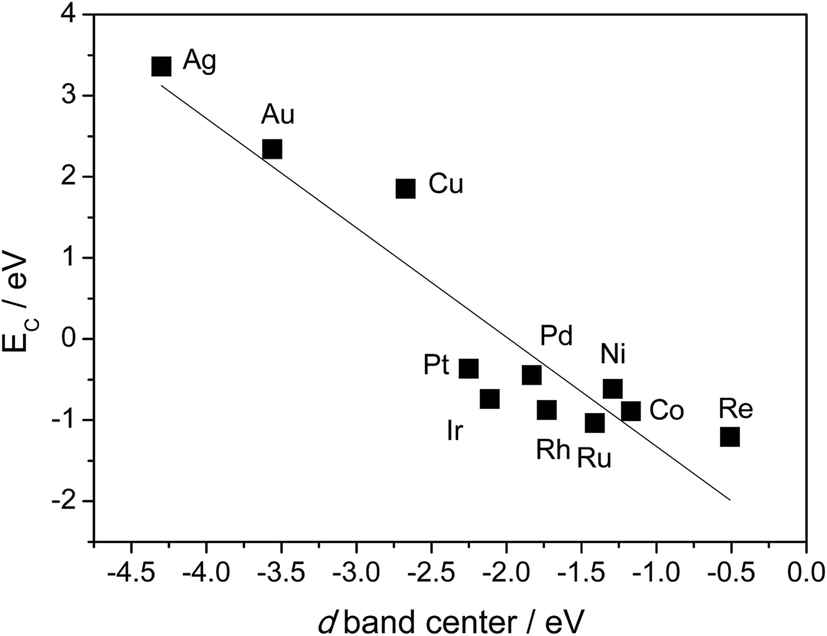

That sounds a bit weird. It is quite strange that there are many papers out there reporting rather different d-band-center value for Cu. It sort of convinced me that Cu should have a lower d-band-center and thus a much weaker H2 or O2 adsorption property.
Actually I found a picture from Hammer and Norskov that shows an obviously higher d-band-center of Cu than Pt. Definitely not the result I got.
B. Hammer and J. K. Nørskov, Advances in Catalysis, ed. H. K. Bruce and C. Gates, Academic Press, 2000, vol. 45, p. 99
Any thoughts?
Thanks for helping!
