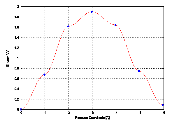

hi, everyone.
Recently, I did some stacking fault energy calculations with the CINEB method. During the calculation, the atom positions in x and y directions were fixed, in z directions were fully relaxed. However, the obtained stacking energy curve is not a smooth line, it's a bit like a stepped shape. This is not consistent with the reported in other's literature. Is there something wrong?
Here are my INCAR and POSCAR, the attachment is my obtained mep fingure
