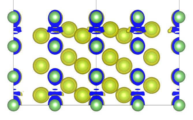

I don't know about the chemistry of metallic Li, but I can see from the charge density (attached) that there is a significant region of charge below the surface atoms which is being associated with the surface atoms in the Bader decomposition.
Screen Shot 2018-10-11 at 4.36.13 PM.png (69.28 KiB) Viewed 31884 times
Re: Charge partitioning issues in cell with vacuum
And here is the valence charge, showing charge below the surface layer.
Screen Shot 2018-10-11 at 4.40.45 PM.png (94.43 KiB) Viewed 31884 times
You might want to double check these calculations using the Li_sv potentials, which should have all three electrons treated as valence.

Thank you for the guidance Prof. Henkelman. I found a very similar result for the charge density, and when computing the Bader charges, using the Li_sv potential. I'll have to do some further research on this to determine if this makes sense from a chemistry perspective, but it's good to know that I'm not introducing any errors by improperly performing the Bader analysis.
